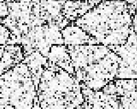

My goal is to create simple geometric line drawings in pure black and white. I do not need gray tones. Something like this (example of training image):
But using that GAN it produces gray tone images. For example, here is some detail from a generated image.
I used this Pytorch based Vanilla GAN as the base for what I am trying to do. I suspect my GAN is doing far too much work calculating all those floats. I'm pretty sure it is normalized to use numbers between -1 and 1 inside the nn? I have read it is a bad idea to try to using 0 and 1 due to problems with tanh activation layer. So any other ideas? Here is the code for my discriminator and generator.

What I have so far pretty much consumes all the available memory I have so simplifying it and / or speeding it up would both be a plus. My input images are 248px by 248px. If I go any smaller than that, they are no longer useful. So quite a bit larger than the MNIST digits (28x28) the original GAN was created over. I am also quite new to all of this so any other suggestions are also appreciated.
EDIT: What I have tried so far. I tried making the final output of the Generator B&W by making the output binary (-1 or 1) using this class:
class Binary(nn.Module):
    def __init__(self):
        super(Binary, self).__init__()
    def forward(self, x):
        x2 = x.clone()
        x2 = x2.sign()
        x2[x2==0] = -1.
        x = x2
        return x
And then I replaced nn.Tanh() with Binary(). It did generate black and white images. But no matter how many epochs, the output still looked random. Using grayscale and nn.Tanh() I do at least see good results.

The output is going to be "continuous" if you don't use it for "classification".
You can follow few approaches here:
  • This would be the simplest approaches but you probably need some post processing to fill holes in lines:
    1. Define a Threshold to make the image binary;
    2. Redefine the last layer to output a image with 2 channels and define your final image by taking the index of the maximum channel value for each pixel (as it was a classification problem)
  • You can also redefine your problem:
PS:Every time a mention "line" from now on I actually mean line segment.
Given that your images are a set of geometric figures, which can all be broken down to lines and any line can be described by a set of 4 numbers, you can use a RNN to generate the set of lines (pair of points) that can be drawn easily afterwards.
To do so you need to rewrite your training set:
  • Define a line width for your images
  • Based on that line width you can set a number of line orientations possible (for example, with width of one pixel you can only draw lines in 4 orientations 0, 45, 90 135 degrees)
  • Use that to find every point that define line (start and end) by finding points where these orientation changes
  • To transform the set of points into a set of lines you can check if there is a black pixel in that orientation that is in the interval.
Binary Layer Issue
Your binary layer implements a Heaveside Step function which will kill the gradient since it's derivative is 0 for all values other than x=0. In x=0 the derivative is actually not defined (limit goes to infinity).
Thus your weights can't update, so every forward pass will filter data with random weights, causing random effects to the output.
Check this answer to understand more about why we don't use Heaveside Step function as an activation function on neural networks
