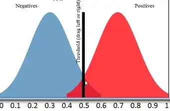

I.e, when we have a sample that belongs to c1, we only look at the predictive score of c1, and build a predictive score distribution of the positive samples. Then we look at samples that belongs to either c2 and c3,i.e the bunched together negative samples and we look at their prediction scores and build a distribution of those scores as well. This results in something like the following:
positive sample and negative sample distributions
Based on those distributions we can get the TPRs and FPRs based of some thresholds and calculate the ROC for c1. Then we can do the same for c2 and c3, and if we want we can average over the three ROC curves, to get an aggregated score for the problem.
