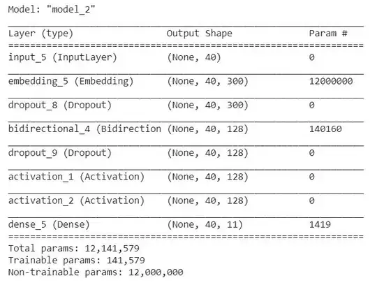

I'm trying to reproduce the codes in this paper here for the multi-labeling problem (11 classes), which is using
1- Embedding layer
2- GRU
3- two Feed forward Layers with the ReLU activation function
4- sigmoid unit.
I've tried to run the codes, but it is showing the following error:
ValueError: Error when checking target: expected dense_5 to have 3 dimensions, but got array with shape (6838, 11)
Edit: The error is fixed. I changed the "return_sequences" to False, and removed flatten() to fix the error.
My code: i'm not sure if 2 Feedforward layers are correct. in the paper it stated FF1:1024 units, and FF2: 512 units. with mini-batch size of 32. How can I state it in the code?

and here is the layers

The error is caused by return_states = True. You set it to True only if you feed the output of a recurrent layer to another. The "states" are the hidden states of recurrent cells, that could be fed to Dense() layers only though Flatten().
Moreover, I suggest you to delete the Dropout() layer. Don't put it after an Embedding(), it contains information (i.e. the learned representation of words/chars) that is not safe to be distorted by dropout. This is just a suggestion of course.
EDIT:
You need return_sequences = True only when a recurrent layer outputs to another recurrent layer. If the following layer is Dense(), then you can drop return_sequences = True and also Flatten().
