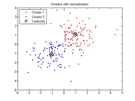

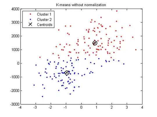

K-means clustering is "isotropic" in all directions of space and therefore tends to produce more or less round (rather than elongated) clusters. In this situation leaving variances unequal is equivalent to putting more weight on variables with smaller variance.
Example in Matlab:
X = [randn(100,2)+ones(100,2);...
     randn(100,2)-ones(100,2)];
% Introduce denormalization
% X(:, 2) = X(:, 2) * 1000 + 500;
opts = statset('Display','final');
[idx,ctrs] = kmeans(X,2,...
                    'Distance','city',...
                    'Replicates',5,...
                    'Options',opts);
plot(X(idx==1,1),X(idx==1,2),'r.','MarkerSize',12)
hold on
plot(X(idx==2,1),X(idx==2,2),'b.','MarkerSize',12)
plot(ctrs(:,1),ctrs(:,2),'kx',...
     'MarkerSize',12,'LineWidth',2)
plot(ctrs(:,1),ctrs(:,2),'ko',...
legend('Cluster 1','Cluster 2','Centroids',...
       'Location','NW')
title('K-means with normalization')
(FYI: How can I detect if my dataset is clustered or unclustered (i.e. forming one single cluster)

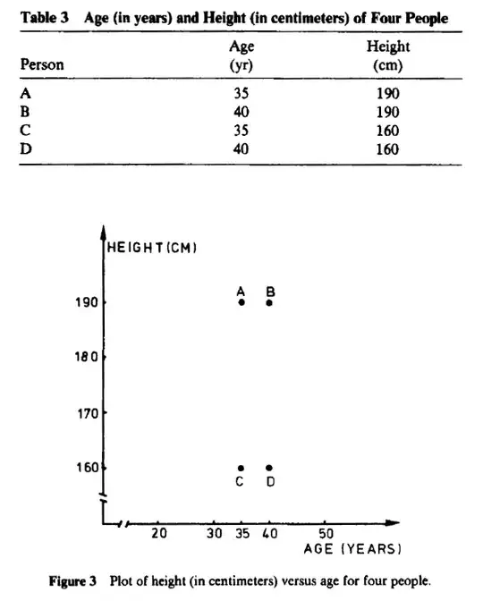

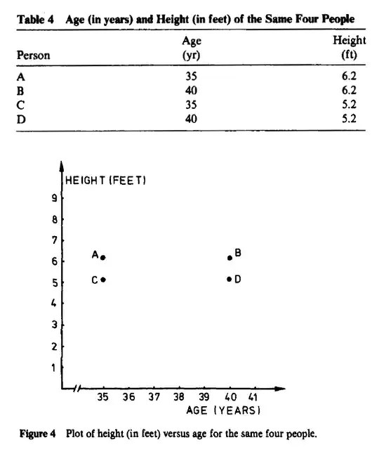

Interestingly, changing the measurement units may even lead one to see a very different clustering structure: Kaufman, Leonard, and Peter J. Rousseeuw.. "Finding groups in data: An introduction to cluster analysis." (2005).
In some applications, changing the measurement units may even lead one to see a very different clustering structure. For example, the age (in years) and height (in centimeters) of four imaginary people are given in Table 3 and plotted in Figure 3. It appears that {A, B ) and { C, 0) are two well-separated clusters. On the other hand, when height is expressed in feet one obtains Table 4 and Figure 4, where the obvious clusters are now {A, C} and { B, D}. This partition is completely different from the first because each subject has received another companion. (Figure 4 would have been flattened even more if age had been measured in days.)
To avoid this dependence on the choice of measurement units, one has the option of standardizing the data. This converts the original measurements to unitless variables.

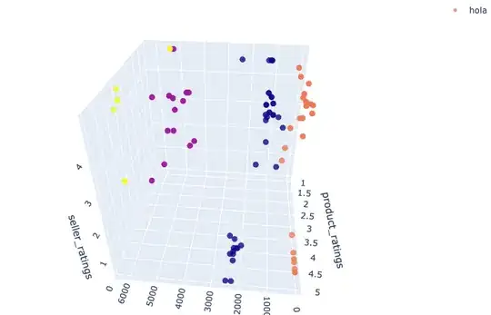

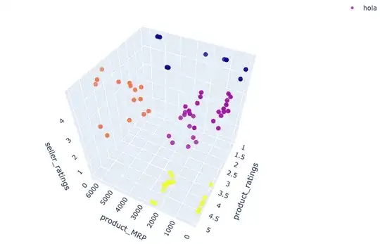

I was wondering the same thing, then I tried something very logical. I experimented with both the cases.
Here's a nice clustering plot, with round clusters, with scaling: enter image description here
Here's the clearly skewed clustering plot, one without scaling!
In the second plot, we can see 4 vertical planar clusters. Clustering algorithm k-means is completely dominated by the large product_mrp values here.
