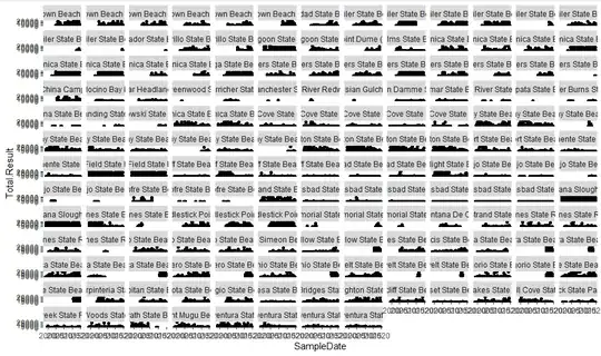

I have a collection of bacteria data from approximately 140 monitoring locations in California. I would like to produce a scatterplot for each monitoring location with the Sampling Date on the Y-axis and the Bacteria Data on the X-axis. The Sampling Date, Bacteria Data, and Monitoring Location all reside within their own column.
I've come up with the below code:

## Construct Plots ##
ggplot(All_Data) + geom_point(mapping =aes(SampleDate, Total.Result)) + facet_wrap( ~ Identifier) +ylim(0,20000)
but this produces the below plot where every single location is crammed into the plot frame. Is there a way to print each plot individually to a folder? enter image description here

Alternatively, is it better to do this through some sort of loop through the original 15 csvs that I've combined together? I would still have the challenge of creating one plot per monitoring location. Thanks in advance for any suggestions!

I finally figured out something that works:
plot_list = list()
for (i in Monitoring_Locations){
     p = ggplot(All_Data) +geom_point(aes(SampleDate, Total.Result))
     plot_list[[i]] = p
for (i in Monitoring_Locations) {
  file_name = paste("Scatter", i, ".tiff", sep="")
  tiff(file_name)
  print(plot_list[[i]])
  dev.off()
The only problem is, this prints out an identical plot for each separate location, essentially fitting ALL of the data in column Total.Result onto one plot and replicating it 164 times. Is there something missing in my loop that would tell it to group the data based off of the Identifier?
