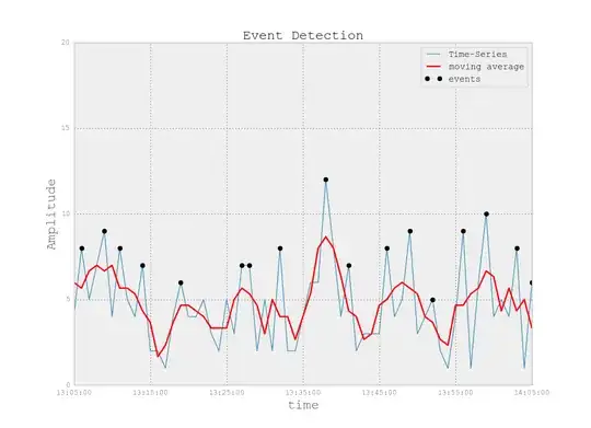

Anomaly Detection or Event Detection can be done in different ways:
Basic Way
Derivative! If the deviation of your signal from its past & future is high you most probably have an event. This can be extracted by finding large zero crossings in derivative of the signal.
Statistical Way
Mean of anything is its usual, basic behavior. if something deviates from mean it means that it's an event. Please note that mean in time-series is not that trivial and is not a constant but changing according to changes in time-series so you need to see the "moving average" instead of average. It looks like this:
Events are peaks larger than 1 standard deviation from moving average
The Moving Average code can be found here. In signal processing terminology you are applying a "Low-Pass" filter by applying the moving average.
You can follow the code bellow:
MOV = movingaverage(TimeSEries,5).tolist()
STD = np.std(MOV)
events= []
ind = []
for ii in range(len(TimeSEries)):
    if TimeSEries[ii] > MOV[ii]+STD:
        events.append(TimeSEries[ii])
Probabilistic Way
They are more sophisticated specially for people new to Machine Learning. Kalman Filter is a great idea to find the anomalies. Simpler probabilistic approaches using "Maximum-Likelihood Estimation" also work well but my suggestion is to stay with moving average idea. It works in practice very well.
I hope I could help :) Good Luck!

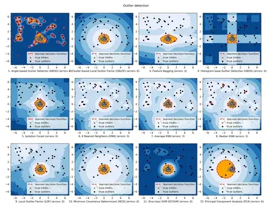

I recently developed a toolbox: Python Outlier Detection toolbox (PyOD). See GitHub.
It is designed for identifying outlying objects in data with both unsupervised and supervised approaches. PyOD is featured for:
  • Unified APIs, detailed documentation, and interactive examples across various algorithms.
  • Advanced models, including Neural Networks/Deep Learning and Outlier Ensembles.
  • Optimized performance with JIT and parallelization when possible, using numba and joblib. Compatible with both Python 2 & 3 (scikit-learn compatible as well).
Here are some important links:
If you use PyOD in a scientific publication, we would appreciate citations to the following paper
@article{zhao2019pyod,
  title={PyOD: A Python Toolbox for Scalable Outlier Detection},
  author={Zhao, Yue and Nasrullah, Zain and Li, Zheng},
  journal={arXiv preprint arXiv:1901.01588},
  year={2019},
  url={https://arxiv.org/abs/1901.01588}
It is currently under review at JMLR (machine learning open-source software track). See preprint.
Quick Introduction
PyOD toolkit consists of three major groups of functionalities: (i) outlier detection algorithms; (ii) outlier ensemble frameworks and (iii) outlier detection utility functions.
Individual Detection Algorithms:
  • PCA: Principal Component Analysis (the sum of weighted projected distances to the eigenvector hyperplanes)
  • MCD: Minimum Covariance Determinant (use the mahalanobis distances as the outlier scores)
  • OCSVM: One-Class Support Vector Machines
  • LOF: Local Outlier Factor
  • CBLOF: Clustering-Based Local Outlier Factor
  • LOCI: LOCI: Fast outlier detection using the local correlation integral
  • HBOS: Histogram-based Outlier Score
  • kNN: k Nearest Neighbors (use the distance to the kth nearest neighbor as the - **outlier score
  • AvgKNN: Average kNN (use the average distance to k nearest neighbors as the outlier score)
  • MedKNN: Median kNN (use the median distance to k nearest neighbors as the outlier score)
  • ABOD: Angle-Based Outlier Detection
  • FastABOD: Fast Angle-Based Outlier Detection using approximation
  • SOS: Stochastic Outlier Selection
  • IForest: Isolation Forest
  • Feature Bagging
  • LSCP: LSCP: Locally Selective Combination of Parallel Outlier Ensembles
  • XGBOD: Extreme Boosting Based Outlier Detection (Supervised)
  • AutoEncoder: Fully connected AutoEncoder (use reconstruction error as the outlier score)
  • SO_GAAL: Single-Objective Generative Adversarial Active Learning
  • MO_GAAL: Multiple-Objective Generative Adversarial Active Learning
Outlier Detector/Scores Combination Frameworks:
  • Feature Bagging
  • Average: Simple combination by averaging the scores
  • Weighted Average: Simple combination by averaging the scores with detector weights
  • Maximization: Simple combination by taking the maximum scores
  • AOM: Average of Maximum
  • MOA: Maximization of Average
Utility Functions for Outlier Detection:
  1. score_to_lable(): convert raw outlier scores to binary labels
  2. precision_n_scores(): one of the popular evaluation metrics for outlier mining (precision @ rank n)
  3. generate_data(): generate pseudo data for outlier detection experiment
  4. wpearsonr(): weighted pearson is useful in pseudo ground truth generation
Comparison of all implemented models are made available below: (Figure, Code, Jupyter Notebooks):enter image description here
If you are interested, please check Github for more information.
