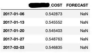

Here is what the .head() of my dataframe looks like:
My dataframe for ARIMA
As you can see it has date at its index with 4 observations/month starting at 06/01/2017. This df has 138 populated _COST observations or 155 observations with empty ones for future forecasting.

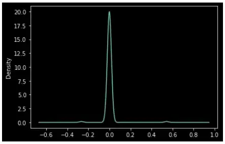

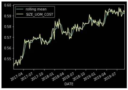

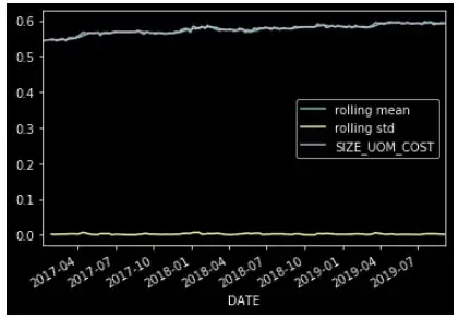

Now, moving into testing/understanding my df, here is how my rolling mean, rolling std and residual error plots look:
Rolling Mean plot Rolling std plot Residual errors plot
Here, I can confirm a couple of things: it has upwards trend, no seasonality, variance doesn't change much, residual errors are close to 0.

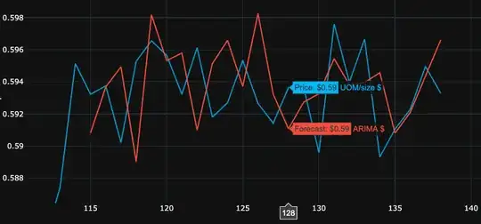

Finally, after doing all that - I move on to see my ARIMA model forecast... I decided to use (1,1,0) or differenced first-order autoregressive model as if it was correct choice in my mind (Please let me know if I'm wrong!) Here is the performance of my model; I decided to forecast last 12 weeks and this is what it looks like when I zoom in: ARIMA plot
So, looking at this visually I'm not too happy about it...Looking at this on y-axis, because I'm working with $0.## cents it pretty much hits the numbers right.
Is this a good/bad performance? Is there some metrics to look for (such as precision, accuracy, f-1 or something in that nature as used with other machine learning models?)
