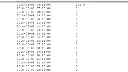

Here I have a dataset with three inputs. Here I generated y value using append. After the append I got the output like this:
 y.append(rec.iloc[0]['y'])
Then I tried to develop neural network model with these values. Before that I tried to scale the y value. my code:

It is basically what the error message says. The problem is this:
y =y.values().astype(int)
y is a list and lists do not have a method values() (but dictionaries and DataFrames do).
If you would like to convert y to a list of integers you can use list comprehension:
y = [int(x) for x in y]
Or alternatively use map (but I'd prefer the list comprehension):
y = list(map(int, y))
