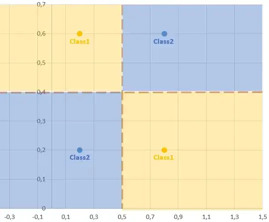

I have read online that decision trees can solve xOR type problems, as shown in images (xOR problem: 1) and (Possible solution as decision tree: 2).
My question is how can a decision tree learn to solve this problem in this scenario. I just don't see a way for any metric (Information gain, Gini Score, ...) to choose one of the splits in image 2 over any other random split.

Indeed, the first split is probably quite random, or due to noise (if you go for $\operatorname{sign}(x\cdot y)$ with continuous $x,y$ instead of the discrete $x,y$ and XOR). But, as long as your algorithm makes the plunge with one of those first splits, the next splits are obvious and your tree will make them.

This can be applied to continuous values as well. I will demonstrate with the example you provided. In your example, we need to make a decision tree that considers the following:
if (x < 0.5 AND y > 0.4) OR (x > 0.5 AND y < 0.4)
  class = 1
else
  class = 2
Like the discrete example, this can be solved using three decision nodes:
N1: is x > 0.5 ? (yes -> N2, no -> N3)
N2: is y > 0.4 ? (yes -> class=2, no -> class=1)
N3: is y > 0.4 ? (yes -> class=1, no -> class=2)
Note that you can choose > or >= to skew classification toward your preferred class when a point falls precisely on the boundary.
I have pasted your example image here for reference: Your example
