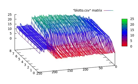

The real data looks like this:
Here, I see 3 clusters: [0..50], [50..200], [200..250]

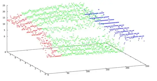

I used modified k-means and got this acceptable result:
Borders of clusters: [0, 38, 195, 246]

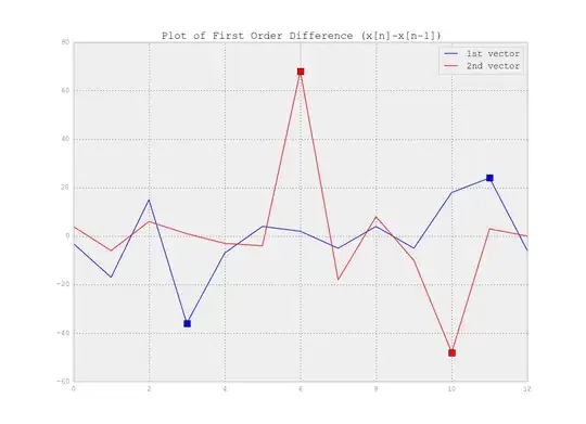

As you correctly stated you do not need Clustering but Segmentation. Indeed you are looking for Change Points in your time series. The answer really depends on the complexity of your data. If the data is as simple as above example you can use the difference of vectors which overshoots at changing points and set a threshold detecting those points like bellow: enter image description here As you see for instance a threshold of 20 (i.e. $dx<-20$ and $dx>20$) will detect the points. Of course for real data you need to investigate more to find the thresholds.

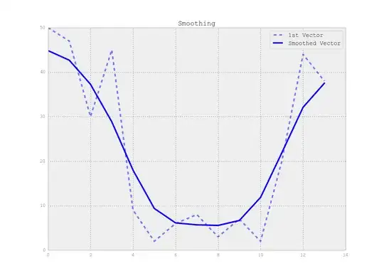

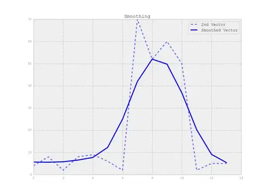

Please note that there is a trade-off between accurate location of the change point and the accurate number of segments i.e. if you use the original data you'll find the exact change points but the whole method is to sensitive to noise but if you smooth your signals first you may not find the exact changes but the noise effect will be much less as shown in figures bellow:
Conclusion
My suggestion is to smooth your signals first and go for a simple clustering mthod (e.g. using GMMs) to find an accurate estimation of the number of segments in signals. Given this information you can start finding changing points constrained by the number of segments you found from previous part.
