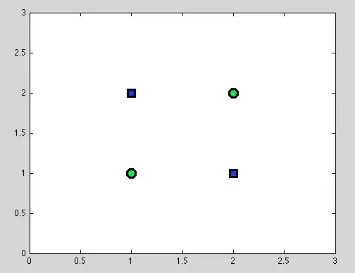

Assume first point. It is not always possible to find the best split. For example in the following dataset each split will give exactly one misclassified object. Example of the dataset with no best split
And I think that exactly this point can be confusing: indeed, the behaviour of the individual split is somehow similar to the behaviour of Naive Bayes classifier: if the variables are dependent - there is no better split for Decision Trees and Naive Bayes classifier also fails (just to remind: independent variables is the main assumption that we make in Naive Bayes classifier; all other assumptions come from the probabilistic model that we choose).

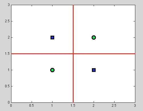

But here comes the great advantage of decision trees: we take any split and continue splitting further. And for the following splits we will find a perfect separation (in red). Example of the decision boundary
And as we have no probabilistic model, but just binary split, we don't need to make any assumption at all.

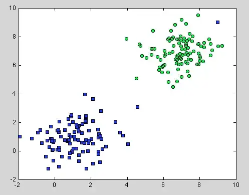

That was about Decision Tree, but it also applies for Random Forest. The difference is that for Random Forest we use Bootstrap Aggregation. It has no model underneath, and the only assumption that it relies is that sampling is representative. But this is usually a common assumption. For example, if one class consist of two components and in our dataset one component is represented by 100 samples, and another component is represented by 1 sample - probably most individual decision trees will see only the first component and Random Forest will misclassify the second one. Example of weakly represented second component
