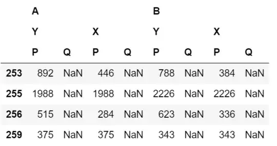

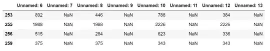

This is the original Dataframe: enter image description here What I wanted : I wanted to convert this above data-frame into this multi-indexed column data-frame : enter image description here I managed to do it by this piece of code :
# tols : original dataframe
cols = pd.MultiIndex.from_product([['A','B'],['Y','X']
['P','Q']])
tols.set_axis(cols, axis = 1, inplace = False)

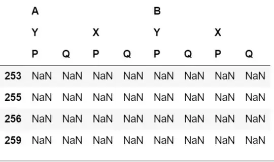

it resulted in an output like this : enter image description here
My problem : As you could see in the output above all my original numerical values go missing on employing the reindex method. In the documentation page it was clearly mentioned : Conform DataFrame to new index with optional filling logic, placing NA/NaN in locations having no value in the previous index. A new object is produced unless the new index is equivalent to the current one. So i don't understand:
  • Where did i particularly err in employing the reindex method to lose my original values
  • How should i have employed the reindex method correctly to get my desired output
