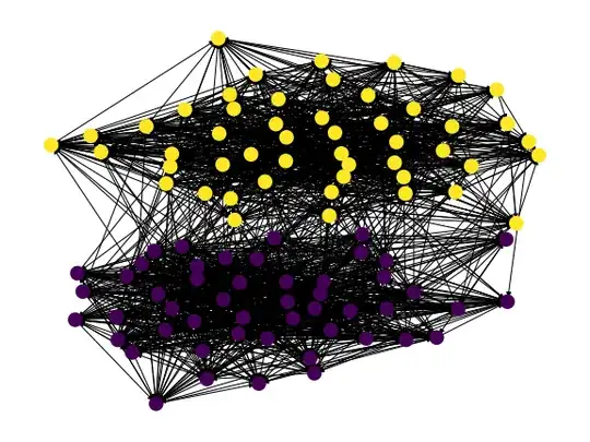

Here is a rough implementation of a solution (feedback welcome). To build the Graph encoder, I followed the tutorial here (https://antoniolonga.github.io/Pytorch_geometric_tutorials/posts/post6.html)
I start by making a graph on 100 nodes with a community structure. Namely two strongly connected communities.
To do this graph I used the following code

I then define a dataset. Node features is just the identity matrix.
graph = data.Data(x=torch.eye(100), edge_index=edges, edge_attr=edges_attr)
data = train_test_split_edges(graph)

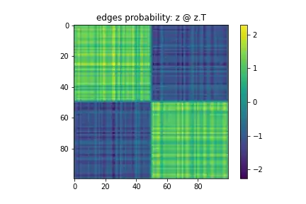

plt.imshow((z @ z.t()).detach()) plt.colorbar() plt.title("edges probability: z @ z.T") plt.savefig("example_out.png") plt.show()
By decoding the embedded space we get a similar community structure enter image description here
