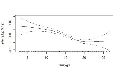

I really need help with GAM. I have to find out whether association is linear or non-linear by using GAM. The predictor variable is temperature at lag0 and the output is cardiovascular admissions (count variable). I have tried a lot but I am not able to understand how to interpret the graph and output that I am getting.
I tried this formula using mgcv package:
model1<- gam(cvd ~ s(templg0), family=poisson)
summary(model1)
plot(model1)
So here is the output for summary that I am getting:
Family: poisson
Link function: log
Formula: cvd ~ s(templg0)
Parametric coefficients: Estimate Std. Error z value Pr(>|z|)
(Intercept) 3.195669 0.004877 655.2 <2e-16 ***
Signif. codes: 0 ‘*’ 0.001 ‘’ 0.01 ‘*’ 0.05 ‘.’ 0.1 ‘ ’ 1
Approximate significance of smooth terms: edf Ref.df Chi.sq p-value
s(templg0) 3.422 4.295 57.23 2.93e-11 ***
R-sq.(adj) = 0.0152 Deviance explained = 1.68% UBRE = 1.016 Scale est. = 1 n = 1722
Can someone please explain the output in detail. What this output is explaining? and also can someone help what this plot (picture attached) is showing? Please be kind as I have invested a lot of time but can not find how to interpret this.

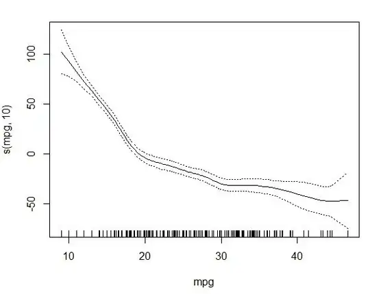

GAM Example:
library(gam)
library(ISLR)
df = ISLR::Auto
# GAM with 10 knots
gam5= gam(horsepower ~ s(mpg, 10), data=df)
summary(gam5)
plot(gam5, se=T)
GAM Result:
Would you conclude that your model is linear? No. In the range between about ]mpg=0 to mpg=20[ there is a linear relation as well as betweeen ]mpg=20 to mpg=40[. But linearity does not hold for the entire range of data. So I would differentiate these segments, e.g. by dummy encoding and interaction terms.
Note that the y-axis is rescaled. So there is no natural interpretation of the y-axis here.

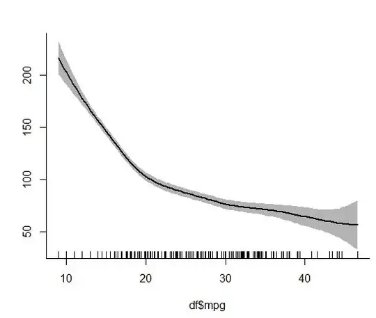

Comparison to non-parametric (NP) estimation:
To deal with non-linearity non-parametric regression is an obvious alternative. What happens if we do NP?
# Nonparametric regression
library(SemiPar)
fit <- spm(df$horsepower ~ f(df$mpg))
plot(fit)
NP Result:
As you can see NP delivers almost the same result. However, the y-axis in the figure has a natural interpretation, which can be useful.
What about your Problem:
First make sure that you check different values for k in s(...,k), so check different number of knots and see how the figure changes. Also have a look at the book to understand the background.
In your current figure, I see some kinks at about x=10 and x=20. However, I would not say that this is severe non-linearity (but there is non-linearity in the data). Generally, if you can draw a line over the plot range (along the x-axis), and if this line is not outside your confidence bands, you can claim for a linear relationship.
Peter
  • 7,896
  • 23
  • 50
The z-value (see glm output) shows predictor variable (temperature at lag0) has a statistically significant positive effect on the cardiovascular admissions. A substantive value of chi-square also support the idea of major effect of temperatures.(Note that p-value indicates the observed sample is random i.e. randomly distributed). The Graph is showing the GAM part . In no case,it evaluates whether there is a linear or the non-linear association.
