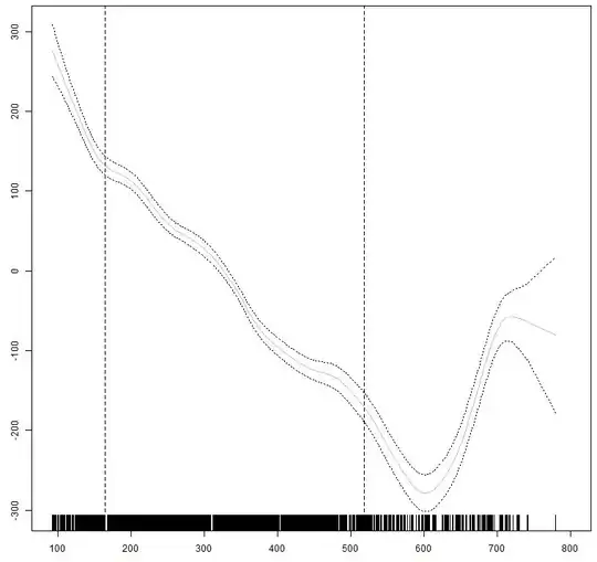

Yet another possibility would be that you "split" your data. Here I assume that only observations in some range cause trouble (in you figure the "low" x's) while the rest of the observations ("higer" x's) follow a linear trend or so. I had exactly the same problem recently. I had a linear trend for the largest part of my x's, while only few observations had a highly non-linear pattern. I detected this using generalised additive models (GAM). Here is a tutorial for a Python implementation.
This was my result: enter image description here
The figure shows that there is a mostly linear trend for the largest part of the data (lower 90% here). Only the upper 10% caused trouble. So I estimated a linear model, but added an interaction term to alow for a separate slope for the upper 10% of data. By doing so I got a reasonable linear estimate for the slope of the lower 90%, while avoiding a "biased" estimate by the "wobbly" upper 10% of data. This works as follows: you generate a dummy/indicator variable which equals I=1 for the "wobbly" data and I=0 otherwise. Then you estimate a linear model like: y = b0 + b1*X + b2*I + b3*I*X + u. The result is that you get an extra intercept (b2) and slope (b3) for the "wobbly" part of the data indicated by I. This in turn means that you also get an extra slope for the non-wobbly part of the data (b0, b1).
