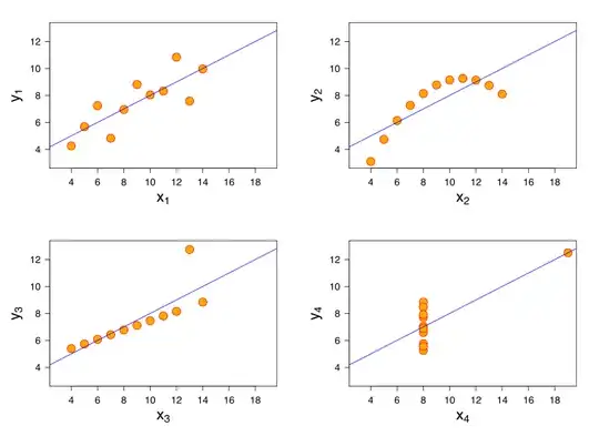

Consider a linear regression model. The same linear regression model can have identical fit to data that have very different characteristics. A famous demonstration of this is through Anscombe's quartet.
All four sets are identical when examined using simple summary statistics, but vary considerably when graphed
Thought I don't have references, I believe this problem can also arise in logistic regression, generalized linear models, SVM, and K-means clustering.
