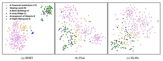

  • If you have no data, you could try a nearest neighbor approach like in this article, where the authors specifically show their approach with "bank" for different contextualized word embeddings (see figure below). You should also have a look at this other article, where they also study the geometry of BERT representations in relation to WSD.
