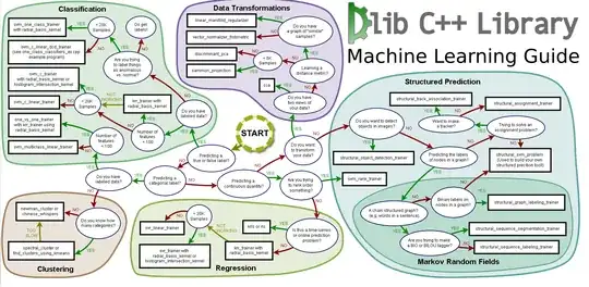

However, if you want to stay in C/C++, you might want to have a look at Dlib:
Dlib is a general purpose cross-platform C++ library designed using contract programming and modern C++ techniques. It is open source software and licensed under the Boost Software License.
