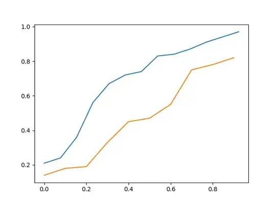

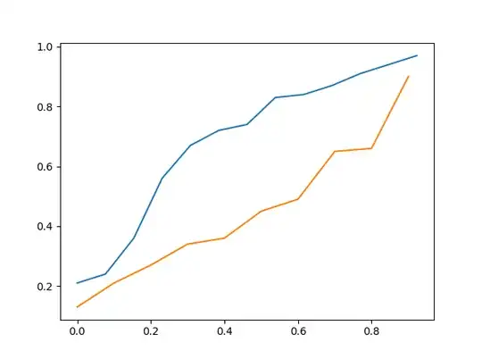

I graphed the cdf of real data vs cdf of simulated data and try to see visually that which one is the closest.
cdf of data_a vs data_b
Above is the cdf of data_a vs cdf of data_b enter image description here
Above is the cdf of data_a vs cdf of data_c
So by visually seeing it one might can say that data_c is more closer to data_a then data_b but it is still not accurate.
