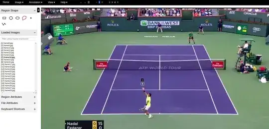

I want to use CNN transfer learning to track a tennis ball from TV broadcasts of tennis matches. I used VGG annotating tool annotation tool link (use version 1 of the tool for compatibility with matterport code) and have about 200 frames annotated with ball location and x,y coordinates given by the tool for the bounding circle.
Like this:
VGG annotation tool on tennis video frame But, the ball is occluded by the bottom player's body or the net tape at times and at others practically invisible because it's moving too fast (other times, it is elliptical in the direction its moving).

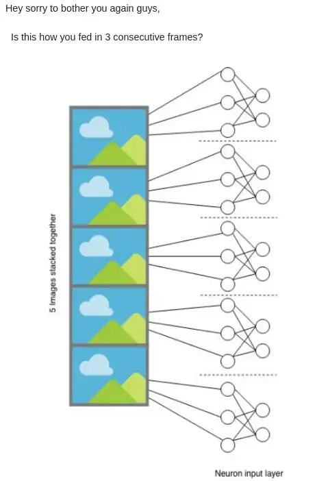

A potential solution I saw used is below in an algorithm called Tracknet. Tracknet: Tracknet ball tracking I contacted the creators of it and was told that they would open source but it's been over a year so I want to try to mimic it.
Edit: My Q and A via email with the Tracknet Team:
question to Tracknet Team
No.
We concatenate three images that are 9 slices in total and then input them together into a network but keep the rest of the network the same. In such a method, the calculation overhead is only on the first layer.
If you would like to have a design like the figure in your previous email, we would suggest you applying an RNN or LSTM to track the ball.
Best, Tsi-Ui
"9 slices in total"...does this mean RGB for each of 3 consecutive frames?

Here is the code snippet where they concatenate three frames in predict_video.py.
#combine three imgs to  (width , height, rgb*3)
X =  np.concatenate((img, img1, img2),axis=2)
mLstudent33
  • 604
  • 20
You usually feed three color layers. So add additional frames like colors so you have 9 "color" frames for the image. The neural network will then automatically estimate how to treat each "color" layer.
