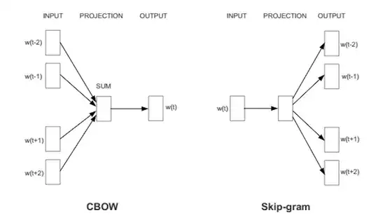

The following diagram explains the difference between the two approaches.
WordVectors
In case you want to further understand the nitty gritty of these two approaches, there are tons of blogs out there.
Now let us look at what the image is trying to tell us.
For CBOW, it looks at the neighboring words to provide a probability of another word co-occurring in that space.
For Skipgram, given a word, it provides probabilities of all the other words occurring in the neighborhood.
