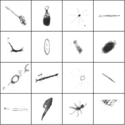

You can see the results on the Data Science bowl images.
Pre-processed images
augmented versions of the same images
