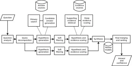

In your situation, I would be curious if I can get information about the inner workings of Watson (obviously, the purpose is only to have a general idea of some steps that are sensible enough to try.) Here is a descriptive image that could be helpful from Wikipedia:
The main idea is to segment questions into its components (using a regular chunking), then come up with several possibilities (hypothesis generation) of what the question might refer to (maybe this step can be implemented as a clustering). The third stage is rating the previous hypothesis based on available information. Finally, you choose the more likely hypothesis. There is a feedback involved in this process using sample questions and their answers. It would be interesting to see if the rating stage can be modeled in terms of a Bayesian or an incremental approach to allow for a feedback.
