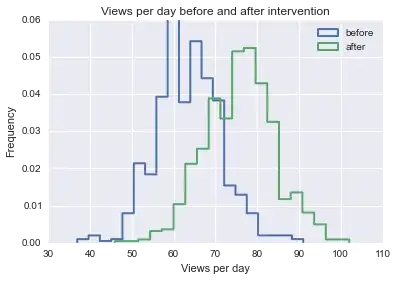

First, let's think about one page before and after an intervention. Pretend the intervention increases hits per day by roughly 15%:
import numpy as np
import seaborn as sns
def simulate_data(true_diff=0):
    #First choose a number of days between [1, 1000] before the intervention
    num_before = np.random.randint(1, 1001)
    #Next choose a number of days between [1, 1000] after the intervention
    num_after = np.random.randint(1, 1001)
    #Next choose a rate for before the intervention. How many views per day on average?
    rate_before = np.random.randint(50, 151)
    #The intervention causes a `true_diff` increase on average (but is also random)
    rate_after = np.random.normal(1 + true_diff, .1) * rate_before
    #Simulate viewers per day:
    vpd_before = np.random.poisson(rate_before, size=num_before)
    vpd_after = np.random.poisson(rate_after, size=num_after)
    return vpd_before, vpd_after
vpd_before, vpd_after = simulate_data(.15)
plt.hist(vpd_before, histtype="step", bins=20, normed=True, lw=2)
plt.hist(vpd_after, histtype="step", bins=20, normed=True, lw=2)
plt.legend(("before", "after"))
plt.title("Views per day before and after intervention")
plt.xlabel("Views per day")
plt.ylabel("Frequency")
plt.show()
Distribution of hits per day before and after the intervention

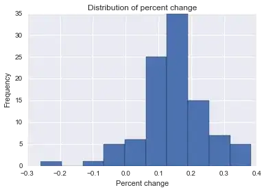

We can clearly see that the intervention increased the number of hits per day, on average. But in order to quantify the difference in rates, we should use one company's intervention for multiple pages. Since the underlying rate will be different for each page, we should compute the percent change in rate (again, the rate here is hits per day).
Now, let's pretend we have data for n = 100 pages, each of which received an intervention from the same company. To get the percent difference we take (mean(hits per day before) - mean(hits per day after)) / mean(hits per day before):
n = 100
pct_diff = np.zeros(n)
for i in xrange(n):
    # % difference. Note: this is the thing we want to infer
    pct_diff[i] = (vpd_after.mean() - vpd_before.mean()) / vpd_before.mean()
plt.hist(pct_diff)
plt.title("Distribution of percent change")
plt.xlabel("Percent change")
plt.show()
Now we have the distribution of our parameter of interest! We can query this result in different ways. For example, we might want to know the mode, or (approximation of) the most likely value for this percent change:
def mode_continuous(x, num_bins=None):
    if num_bins is None:
        counts, bins = np.histogram(x)
    else:
        counts, bins = np.histogram(x, bins=num_bins)
    ndx = np.argmax(counts)
    return bins[ndx:(ndx+1)].mean()
mode_continuous(pct_diff, 20)
When I ran this I got 0.126, which is not bad, considering our true percent change is 15. We can also see the number of positive changes, which approximates the probability that a given company's intervention improves hits per day:
(pct_diff > 0).mean()
Here, my result is 0.93, so we could say there's a pretty good chance that this company is effective.

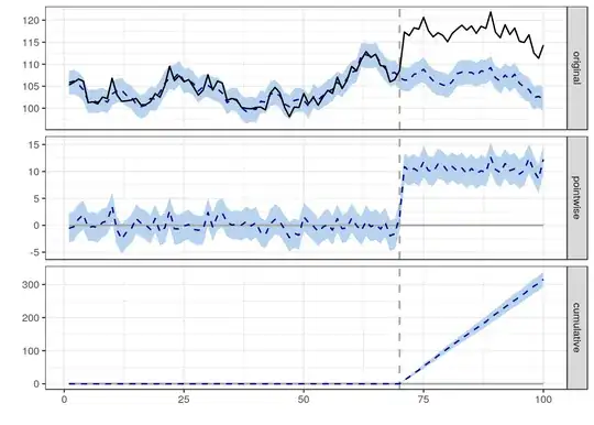

A few years ago (2015), Google published a research paper about the effect a specific event has in a time-series model. You can read more details here Inferring causal impact using Bayesian structural time-series models.
In this GitHub page, you can find a detailed example and description of how it works. In short,
This R package implements an approach to estimating the causal effect of a designed intervention on a time series. For example, how many additional daily clicks were generated by an advertising campaign? Answering a question like this can be difficult when a randomized experiment is not available.
You train your model with pre-event data and after-event data and you get a plot like this one
The first panel shows the data and a counterfactual prediction for the post-treatment period. The second panel shows the difference between observed data and counterfactual predictions. This is the pointwise causal effect, as estimated by the model. The third panel adds up the pointwise contributions from the second panel, resulting in a plot of the cumulative effect of the intervention.
Running the following summary(impact), you get a summary and the estimated impact the event had in your time-series data.
The same library has been ported to Python as well. For example here
