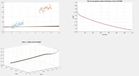

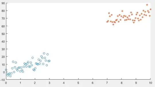

I am running logistic regression on a small dataset which looks like this:
After implementing gradient descent and the cost function, I am getting a 100% accuracy in the prediction stage, However I want to be sure that everything is in order so I am trying to plot the decision boundary line which separates the two datasets.
Below I present plots showing the cost function and theta parameters. As can be seen, currently I am printing the decision boundary line incorrectly.

The above code is implementing gradient descent correctly (I think) but I am still unable to show the boundary line plot. Any suggestions would be appreciated.

Regarding the code
  1. You should plot the decision boundary after training is finished, not inside the training loop, parameters are constantly changing there; unless you are tracking the change of decision boundary.
  2. x1 (x2) is the first feature and dat1 (dat2) is the second feature for the first (second) class, so the extended feature space x for both classes should be the union of (1, x1, dat1) and (1, x2, dat2).

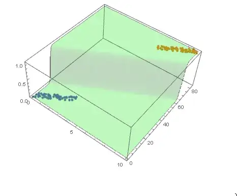

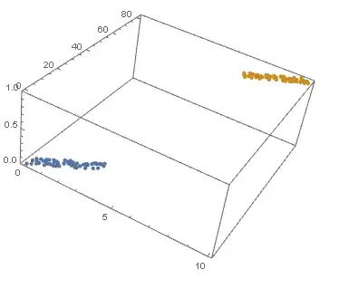

Your decision boundary is a surface in 3D as your points are in 2D.
With Wolfram Language
Create the data sets.
mqtrue = 5;
cqtrue = 30;
With[{x = Subdivide[0, 3, 50]},
  dat1 = Transpose@{x, mqtrue x + 5 RandomReal[1, Length@x]};
With[{x = Subdivide[7, 10, 50]},
  dat2 = Transpose@{x, mqtrue x + cqtrue + 5 RandomReal[1, Length@x]};

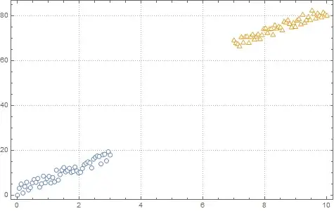

View in 2D (ListPlot) and the 3D (ListPointPlot3D) regression space.
ListPlot[{dat1, dat2}, PlotMarkers -> "OpenMarkers", PlotTheme -> "Detailed"]
Mathematica graphics
I Append the response variable to the data.
datPlot =
 ListPointPlot3D[
  MapThread[Append, {#, Boole@Thread[#[[All, 2]] > 40]}] & /@ {dat1, dat2}
Perform a Logistic regression (LogitModelFit). You could use GeneralizedLinearModelFit with ExponentialFamily set to "Binomial" as well.
With[{dat = Join[dat1, dat2]},
 model =
  LogitModelFit[
   MapThread[Append, {dat, Boole@Thread[dat[[All, 2]] > 40]}],
   {x, y}, {x, y}]
From the FittedModel "Properties" we need "Function".
model["Properties"]
{AdjustedLikelihoodRatioIndex, DevianceTableDeviances, ParameterConfidenceIntervalTableEntries, AIC, DevianceTableEntries, ParameterConfidenceRegion, AnscombeResiduals, DevianceTableResidualDegreesOfFreedom, ParameterErrors, BasisFunctions, DevianceTableResidualDeviances, ParameterPValues, BestFit, EfronPseudoRSquared, ParameterTable, BestFitParameters, EstimatedDispersion, ParameterTableEntries, BIC, FitResiduals, ParameterZStatistics, CookDistances, Function, PearsonChiSquare, CorrelationMatrix, HatDiagonal, PearsonResiduals, CovarianceMatrix, LikelihoodRatioIndex, PredictedResponse, CoxSnellPseudoRSquared, LikelihoodRatioStatistic, Properties, CraggUhlerPseudoRSquared, LikelihoodResiduals, ResidualDeviance, Data, LinearPredictor, ResidualDegreesOfFreedom, DesignMatrix, LogLikelihood, Response, DevianceResiduals, NullDeviance, StandardizedDevianceResiduals, Deviances, NullDegreesOfFreedom, StandardizedPearsonResiduals, DevianceTable, ParameterConfidenceIntervals, WorkingResiduals, DevianceTableDegreesOfFreedom, ParameterConfidenceIntervalTable}
model["Function"]
Use this for prediction
model["Function"][8, 54]
0.0196842
and plot the decision boundary surface in 3D along with the data (datPlot) using Show and Plot3D
modelPlot =

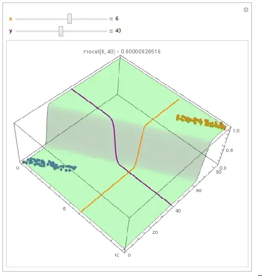

With ParametricPlot3D and Manipulate you can examine decision boundary curves for values of the variables. For example, keeping x fixed and letting y vary or vice versa.
Manipulate[
 Show[
  modelPlot,
  ParametricPlot3D[
   {x, u, model["Function"][x, u]}, {u, 0, 80}, PlotStyle -> Orange],
  ParametricPlot3D[
   {u, y, model["Function"][u, y]}, {u, 0, 10}, PlotStyle -> Purple],
  PlotLabel ->
   StringTemplate["model[`1`, `2`] = `3`"] @@ {x, y, model["Function"][x, y]}
 {{x, 6, Style["x", Orange, Bold]}, 0, 10, Appearance -> "Labeled"},
 {{y, 40, Style["y", Purple, Bold]}, 0, 80, Appearance -> "Labeled"}

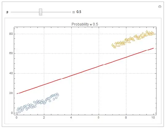

You can also plot contours of the probability in 2D.
plot = ListPlot[{dat1, dat2}, PlotMarkers -> "OpenMarkers", PlotTheme -> "Detailed"];
Manipulate[
 db = y /. First@Quiet@Solve[model["Function"][x, y] == p, y];
 Show[
  plot,
  Plot[db, {x, 0, 10}, PlotStyle -> Red]
 {{p, .5}, 0, 1, Appearance -> "Labeled"}
Hope this helps.

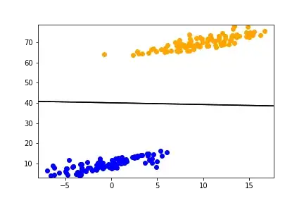

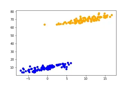

I have generally found that to be quite easy to do in Python without having to solve the boundary equation. (Code mostly adapted from that question in SO)
Import packages :
import numpy as np
from matplotlib import pyplot as plt
from sklearn.linear_model import LogisticRegression
Generate data :
mu_vec1 = np.array([0,10])
cov_mat1 = np.array([[10,8],[8,10]])
x1_samples = np.random.multivariate_normal(mu_vec1, cov_mat1, 100)
mu_vec1 = mu_vec1.reshape(1,2).T # to 1-col vector
mu_vec2 = np.array([10,70]) cov_mat2 = np.array([[10,8],[8,10]]) x2_samples = np.random.multivariate_normal(mu_vec2, cov_mat2, 100) mu_vec2 = mu_vec2.reshape(1,2).T
Plot generated data and save the associated figure :
fig = plt.figure()
plt.scatter(x1_samples[:,0],x1_samples[:,1], c= 'blue', marker='o') plt.scatter(x2_samples[:,0],x2_samples[:,1], c= 'orange', marker='o')
plt.savefig('data_sample.png')
simulated data
Fit the logistic regression :
X = np.concatenate((x1_samples,x2_samples), axis = 0)
y = np.array([0]*100 + [1]*100)
model_logistic = LogisticRegression() model_logistic.fit(X, y)
Create a mesh, predict the regression on that mesh, plot the associated contour along simulated data and save the plot :
h = .02  # step size in the mesh
x_min, x_max = X[:, 0].min() - 1, X[:, 0].max() + 1
y_min, y_max = X[:, 1].min() - 1, X[:, 1].max() + 1
xx, yy = np.meshgrid(np.arange(x_min, x_max, h),
                     np.arange(y_min, y_max, h))
Z = model_logistic.predict(np.c_[xx.ravel(), yy.ravel()])
fig = plt.figure()
Z = Z.reshape(xx.shape) plt.contour(xx, yy, Z, 1, colors='black')
plt.savefig('data_contour.png')
data + decision boundary
This generally works for more complex dependencies (non linearities in variables) or more complex models (svm as per linked SO answer).
