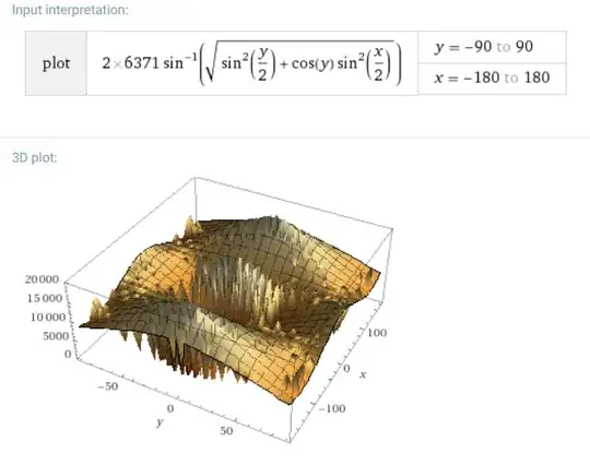

However, as stated before, that couldn't possibly give you a linear relation, as you can see by 3d plotting the function: Relativized Haversine 3D Plot
