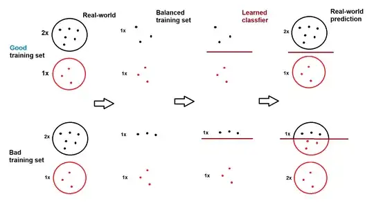

A classifier only tries to capture the features-label relationship as accurate as it can, it does not learn nor does it guarantee that the ratio of predicted labels to be close to the true ratio. However, if sampled classes (even balanced) are good representatives of true class regions and classifier finds good decision boundaries, the closeness of ratios will happen naturally. Therefore, the explanation is that the sampled negative class is not a good representative of its true occupied regions, meaning some regions are not sampled well, and/or classifier is finding bad decision boundaries. Here is a visual illustration (drawn by myself):
In the case of good training set, predictions resemble the real-world ratio (2:1), even though model is trained on a balanced set (1:1). In the case of bad training set and/or bad decision boundary, predictions are completely incompatible (1:2) with the real-world ratio (2:1).
