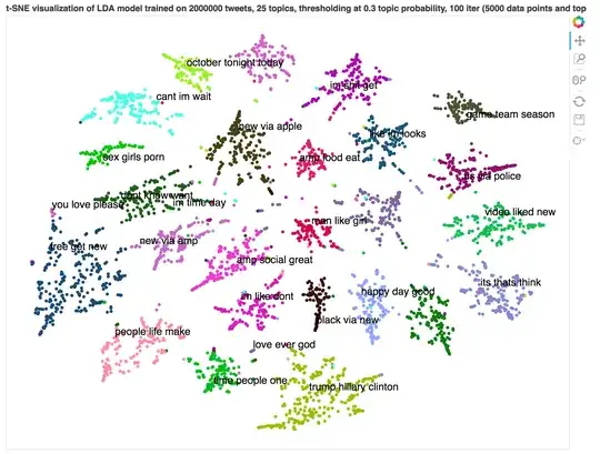

I think, and have done similar problem too, that this problem can be solved in this way:
1. Generate NGrams
2. Create 1 hot encoding matrix
3. Pass to Naive Bayes or Random forest
It would automatically count the words count (you can apply TFIDF too) and based on that weightage will be calculated.
