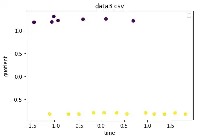

I am starting to learn DBSCAN for clustering but the interpretation part of it seems to be tricky to understand.
dataset = np.vstack((quotient_times, quotient)).T
scaler = StandardScaler()
dataset = scaler.fit_transform(dataset)
db_scan = DBSCAN(eps=0.6, min_samples=1)
db_scan.fit(dataset)
colors = [int(i % 23) for i in db_scan.labels_]
plt.figure();
plt.title(fname)
plt.xlabel("time")
plt.ylabel("quotient")
plt.scatter(dataset[:, 0], dataset[:, 1], c=colors)
plt.legend()
plt.show()
This produces the following plot.
When i print the values of db_scan.labels_, I am getting
array([0, 0, 1, 0, 0, 0, 1, 1, 0, 1, 1, 0, 1, 1, 0, 1, 1, 1, 1, 1])
I was expective my y-axis values from 0-1 and x-axis values from 1-7. Why do I have the negative scales both on the x-axis and y-axis? and how do we interpret these values and the plot?

You copied code that scales data. Hence, the axis changed. But that wasn't DBSCAN, but that was you invoking StandardScaler.
It is important that you understand what you are doing... You have a time axis and a value axis. These are completely different, and computing Euclidean distance does not make any sense...
What you probably wanted to do with such data is GDBSCAN instead. For Generalized DBSCAN you would define two epsilon thresholds:
  1. One threshold for time: how many time steps apart is still the same cluster?
  2. One threshold for values: what difference in values is still the same cluster?
  3. min_samples should always be at least 3, or you are not doing DBSCAN, but Single-Link clustering.
Then run GDBSCAN on that.
Since sklearn does not have GDBSCAN, you can emulate this here by scaling and maximum norm, but that is a bit hackish.

The output from db_scan.labels_ is the assigned cluster value for each of the points that you provide as input to the algorithm.
You provided 20 points, so there are 20 labels. As explained in the relevant documentation, you will see:
labels_ : array, shape = [n_samples] Cluster labels for each point in the dataset given to fit(). Noisy samples are given the label -1.
So each of your points was assigned to one of two clusters, and there were no points marked as noise (receiving a value of -1).
Interpreting the clusters
Your plot shows the original data, plotted on the axes using the original values; only the colour encodes the cluster to which each point was assigned.
As with many clustering algorithms, DBSCAN measures the distance between points in some n-dimensional space. It uses parameters you provide to decide if points belong to the same group, based on their distance from one another.
The distance metrics used do not really care about the sign of the points (where they lie on an axis), simply the distances. In the case of DBSCAN, it is the Euclidean distance. There are other distances that you can pass to the metric parameter of the DBSCAN algorithm; here is the valid list.
