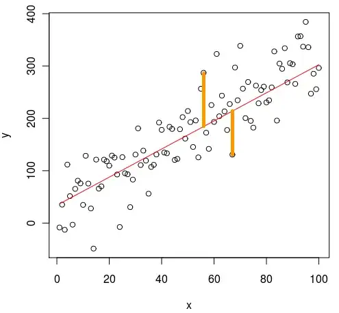

Linear regression does not typically use Euclidean distance. The most common loss for linear regression is the least-squares error. It might be useful to examine this idea visually.
Here is least squared error:
The orange lines show examples of residuals, the delta between predicted and observed for the target variable. Each residual is squared, all of the squares are summed, and then divided by the count.

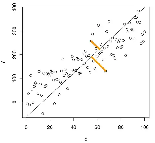

Here is Euclidean distance:
Euclidean distance is different, the orange lines show it as the perpendicular distance of the point to the nearest point on the line.
