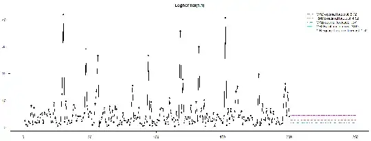

As an example, assume that conditional on our model and predictors, we believe that the future realization follows a lognormal distribution with log-mean $\mu=1$ and log-variance $\sigma^2=1$. Below is a simulated example in time series format, together with the point predictions that minimize each expected error, based on $10^5$ simulations. Since the simulations are IID, the optimal point predictions will be a horizontal flat line. Note that minimizing the MAD, the MAE or the MSLE leads to predictions that are far below the expectation of $\exp\big(\mu+\frac{\sigma^2}{2}\big)=\exp 1.5\approx 4.48$. (I hesitate to call them "biased", because per above, these error measures elicit exactly what they are eliciting, and the issue is just that this elicited functional is not the expectation.)
lognormal example

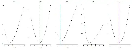

Actually, we can look at different predictions and calculate the expected errors over our $10^5$ simulations. We can then deduce which prediction minimizes the expected error. See below for these plots - the colored vertical lines in each case give the optimal predictions (and correspond to the horizontal prediction lines above, because that is how I got them), while the vertical grey line gives the expectation at about 4.48.
lognormal example: errors

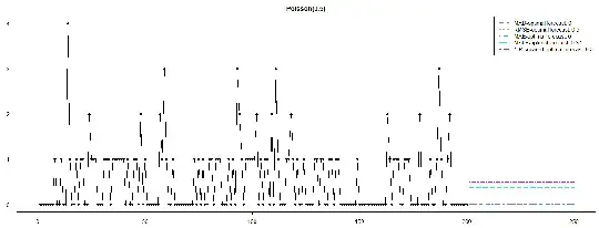

For a second example, we can simulate Poisson data with mean and variance $\lambda=0.5$:
Poisson example

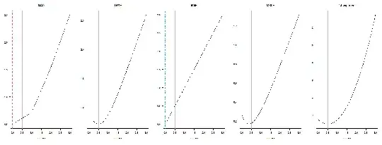

Fun fact: trying to minimize the MAD or MAE incentivizes us to output a flat zero forecast. This is exactly as it should be, since the median of a Poisson(0.5) is zero, but it did make some people working in intermittent demand forecasting rather nervous (Kolassa, 2016). Here are the expected errors against candidate predictions:
Poisson example: errors
