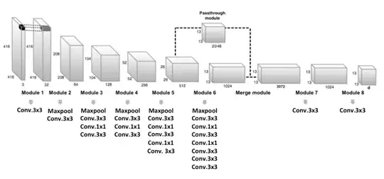

  2. This is done by the CNN. Basically each portion of a convolution corresponds to a grid cell. For example the upper right cell in an image would correspond to the upper right part of the filters in each layer. This is visualized at the left of this image: yolo
