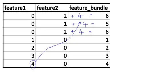

See this article for a bit more detail on how to better explain EFB. Here is a brief visual explanation from there with my own edits. I hope you can appreciate the high production quality of my updated graphic...
To answer your main question see "Part 1 of EFB". This explains that features are ordered by their sparsity and mixed in with all other features. Though not impossible, it seems there is a small chance of them recombining perfectly, given you have enough other features.
