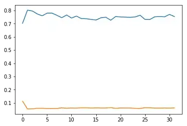

And here's how the training goes (blue is the loss):
I'm not sure what's going wrong- am I even using the class weights correctly? Without the class weights, the model would just predict the dominant class(es) all the time and the accuracy would a baseline of the proportion of samples that had the dominant class(es). But looks like it does poorer than random now.
