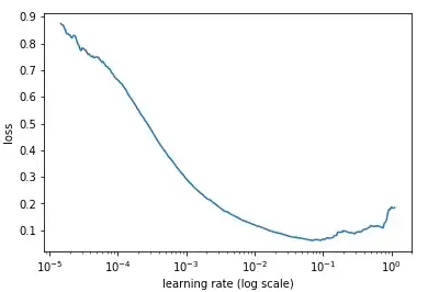

Let me give a brief introduction to another approach on choosing the learning rate, based on Jeremy Howard's Deep Learning course 1. If you want to dig deeper, see this blogpost.
The learning rate proposed in Jeremy Howard's course is based on a systematic way to try different learning rates and choose the one that makes the loss function go down the most. This is done by feeding many batches to the mini-batch gradient descent method, and increasing the learning rate every new batch you feed to the method. When the learning rate is very small, the loss function will decrease very slowly. When the learning rate is very big, the loss function will increase. Inbetween these two regimes, there is an optimal learning rate for which the loss function decreases the fastest. This can be seen in the following figure:
We see that the loss decreases very fast when the learning rate is around $10^{-3}$. Using this approach, we have a general way to choose an approximation for the best constant learning rate for our netowork.

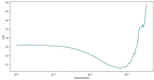

Try using a Learning Rate Finder. Here's an implementation for Keras: https://github.com/WittmannF/LRFinder
You basically have to plot the loss against different learning rates. The steepest area is the best choice of LR. Here's an example:
from keras.models import Sequential
from keras.layers import Flatten, Dense
from keras.datasets import fashion_mnist
!git clone https://github.com/WittmannF/LRFinder.git
from LRFinder.keras_callback import LRFinder
# 1. Input Data
(X_train, y_train), (X_test, y_test) = fashion_mnist.load_data()
mean, std = X_train.mean(), X_train.std()
X_train, X_test = (X_train-mean)/std, (X_test-mean)/std
# 2. Define and Compile Model
model = Sequential([Flatten(),
                    Dense(512, activation='relu'),
                    Dense(10, activation='softmax')])
model.compile(loss='sparse_categorical_crossentropy', \
              metrics=['accuracy'], optimizer='sgd')
# 3. Fit using Callback
lr_finder = LRFinder(min_lr=1e-4, max_lr=1)
model.fit(X_train, y_train, batch_size=128, callbacks=[lr_finder], epochs=2)
In the above example, the best learning rate is about 2e-2. This has been popularized by FastAI. Here's an article with more info: https://medium.com/octavian-ai/how-to-use-the-learning-rate-finder-in-tensorflow-126210de9489

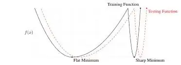

Your intuition that the learning rate related to the shape of the error gradient is correct when the loss is differentiable and convex in relation to its parameters (Theorem 6.1 https://www.stat.cmu.edu/~ryantibs/convexopt-F13/scribes/lec6.pdf).
Generally your loss is high dimensional in its parameter space and therefore non-convex. Moreover, the loss itself is usually Lipschitz continuous with a large constant $L$, which leads to the existence of not only local but also sharp minima.
Sharp vs flat minima
Choosing a learning rate then necessarily depends on both $L$ and the initialization. For a very large $L$, you could still converge with a large learning rate (as opposed to the convex case), as long as the initialization is within a neighbor of a decent flat minima.
