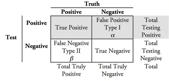

F1Score is a metric to evaluate predictors performance using the formula
F1 = 2 * (precision * recall) / (precision + recall)
where
recall = TP/(TP+FN) and precision = TP/(TP+FP)
