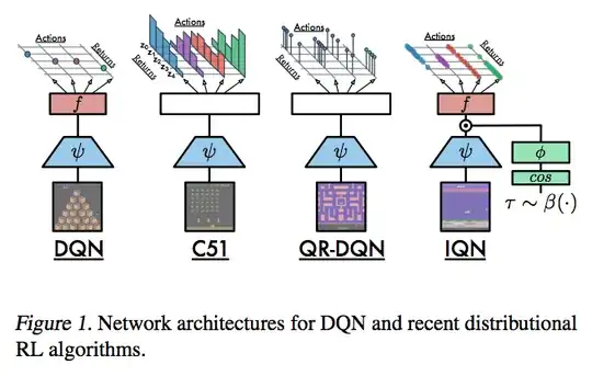

The IQN paper gives a picture, but I am unable to grasp the intuition behind the 4th image:
Why does the above image show the $f$ function being used in DQN and in IQN but not in C51 or QR-DQN? Does that mean that the output is no longer a vector of vectors, but is just a vector, like in a usual DQN?

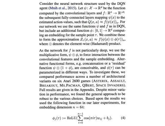

The gist of IQN is in the following paragraph, but I just can't grasp it fully. What's the intuition behind the cosine? I know it's a periodical function, why does it get computed 64 times with i=0 to i=64, with the same $\tau$ (for example $\tau=0.4$ etc)

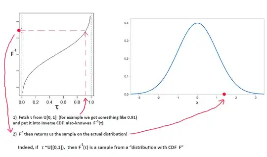

Just like C51 or QR-DQN, IQN allows us to estimate an entire distribution of possible rewards if we take some action $a$. However, IQN doesn't output a distribution like those did. Instead, it outputs a single sample every time you ask it. It outputs that red dot you see on the right, of the bottom image.
The final output of IQN is 1 scalar value per action. In other words, just a single sample per action. We re-run IQN several times to get more samples for the "CurrentState".

Why does feeding a random $\tau$ into the network work?
You have to understand that a well-trained IQN network represents an Inverse CDF itself. That is, given a request of some scalar 'amount' value (taken from a uniform range of 0 to 1), the Inverse CDF will output a value from the actual distribution, that sits at that amount.
Although distributions won't necessarily look like Bell-curves, have a look at this example:
Why do authors use cosine inside $\phi(\tau)$ ? I still have no idea, but the Appendix section of the paper states it seems to work the best. Perhaps it works good with ReLU.
I also got confused by $w_{ij}$ or $b_j$. To me it seemed there is a matrix of weights and a vector of bias values. ...Do we input an entire vector of different $\tau$ values at once?
The answer is no. Notice, authors used $j$ only to remind that forward pass has to run several times. In total, there is only i number of weights in $\phi(\tau)$ and 1 bias.
Therefore, we get some scalar $\tau$, and use it with all those weights. Basically $\phi(\tau)$ resembles a simple fully-connected layer, which only accept 1 scalar input value at a time. We will re-use this same layer for different $\tau$ scalar values.

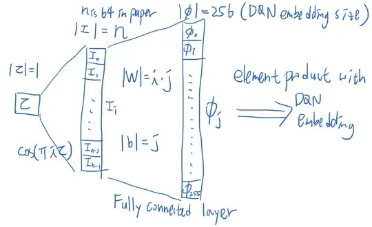

Kari's answer is concise and very informative. However, the explanation for Equation 4 is slightly incorrect. (final section of the post)
$$\phi_j(\tau):=\text{ReLU}(\sum\limits^{n-1}_{i=0}\cos(\pi i\tau)w_{ij}+b_j)$$
$w_{ij}$ is indeed a matrix and $b_j$ is a vector.
It's better to interpret the equation by layers:
layers
Let's say we have a single $\tau$, and we want to perform a single forward pass to get its value $Z_\tau(x_t,a_t)$.
  • Input ($\tau$, $|\tau|=1$)
    We have a scalar $\tau$.
    $$\tau\sim U([0,1])$$
  • Intermediate result ($I_i$, $|I|=n=64$)
    Expand the scalar $\tau$ to a vector by $\cos(\pi i\tau)$ for $i\in[0,n-1]$.
    $$I_i=\cos(\pi i\tau)$$
    The number 64 is used in the paper.
  • Embedding of current $\tau$ ($\phi_j$, $|\phi|=256$)
    Use fully connected layer to expand $I$ to $\phi$ with $|W|=i\cdot j$ and $|b|=j$.
    $$\phi_j(\tau):=\text{ReLU}(\sum\limits^{n-1}_{i=0}I_i w_{ij}+b_j)$$
    The number 256 is the number of neurons of the layer after convolutions in DQN architecture.
  • Then we conduct element-wise multiplication $\psi\odot\phi$ and continues pass it into DQN's last layer.
For multiple passes, we can simply treat all $\tau$ as a batch and run the forward pass in parallel.
The concept above is Universal Value Function Approximator (UVFA), while the cosine term is chosen since it results in good empirical results.
