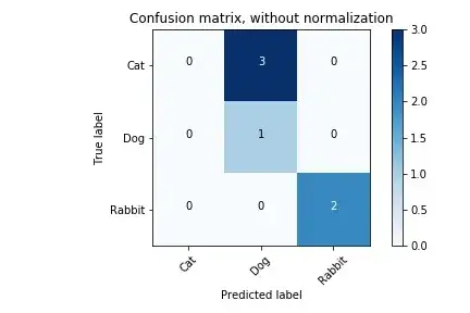

You can even plot it nicely using the below function:

like this:
cnf_matrix = confusion_matrix(y_true, y_pred,labels=['Cat', 'Dog', 'Rabbit'])
np.set_printoptions(precision=2)
# Plot non-normalized confusion matrix
plt.figure()
plot_confusion_matrix(cnf_matrix, classes=['Cat', 'Dog', 'Rabbit'],
                      title='Confusion matrix, without normalization')
