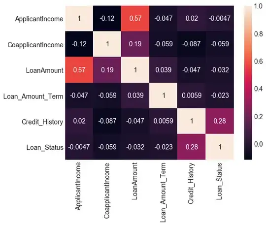

I am trying to build a classification model so I have tried to check the correlation between the features.
Here Loan_Status is my target variable.
I just don't know how to extract information from this? Please help. I have questions like. Is -0.0047 corelation of ApplicantIncome with Loan Status useful?

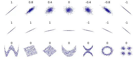

To help you, that shows the correlations between features and each other feature. For example, the number one in the image that you gave, is shown all along the diagonal part of the matrix. The ones represent the 100% linear correlation with one of the features and one of the other features. This image might help: enter image description here
As you can see negative correlations mean that as one feature value increases, the other feature value decreases. A correlation of 0 means that the features appear to have no linear correlation.
