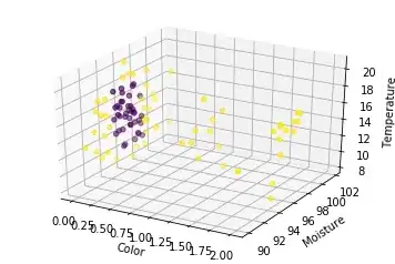

Let's plot the data in 3D
from mpl_toolkits.mplot3d import Axes3D
fig = plt.figure()
ax = fig.add_subplot(111, projection='3d')
ax.scatter(X[:,0], X[:,1], X[:,2], c=y)
ax.set_xlabel('Color')
ax.set_ylabel('Moisture')
ax.set_zlabel('Temperature')
plt.show()
The blue dots are the edible cucumber and the yellow dots are not edible. We can see that this data is not linearly separable so we should expect any linear classifier to be quite poor here. I would presume that random forests would be the best for this data source.

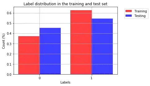

Let's see the distribution of the two different classes in both the training set and testing set
%matplotlib inline
n_classes = 2
training_counts = [None] * n_classes
testing_counts = [None] * n_classes
for i in range(n_classes):
    training_counts[i] = len(y_train[y_train == i])/len(y_train)
    testing_counts[i] = len(y_test[y_test == i])/len(y_test)
# the histogram of the data
train_bar = plt.bar(np.arange(n_classes)-0.2, training_counts, align='center', color = 'r', alpha=0.75, width = 0.41, label='Training')
test_bar = plt.bar(np.arange(n_classes)+0.2, testing_counts, align='center', color = 'b', alpha=0.75, width = 0.41, label = 'Testing')
plt.xlabel('Labels')
plt.xticks((0,1))
plt.ylabel('Count (%)')
plt.title('Label distribution in the training and test set')
plt.legend(bbox_to_anchor=(1.05, 1), handles=[train_bar, test_bar], loc=2)
plt.grid(True)
plt.show()
