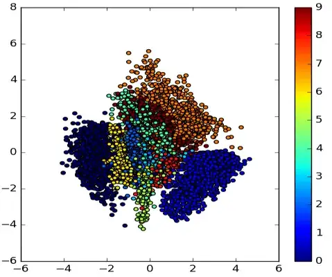

For example, a well trained posterior (first two dimensions) for MNIST looks like this (photo from here)
posterior on MNIST
Notice that the posterior for each digit (e.g. dark blue for digit "0") is distributed like a Gaussian and not far from $\mathcal{N}(0,1)$, but difference digits do occupy different area.
