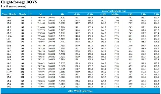

Take for example this data from the World Health Organization, let's only look at age versus height for boys aged 5 to 19. Let's look at a subset of the data in tabular form, I presume you understand the concept of "height-for-age".
Process this chart with your brain, what does it tell you. It tells you exactly everything averaged for a subset of the data. Can you draw any inferences from it, how about another several tables of data?
A neural network would have to process the data in all the tables and come up with a means to say "this age = this height" and "this height = this age" as an average.
Here is one of several tables:
WHO Data

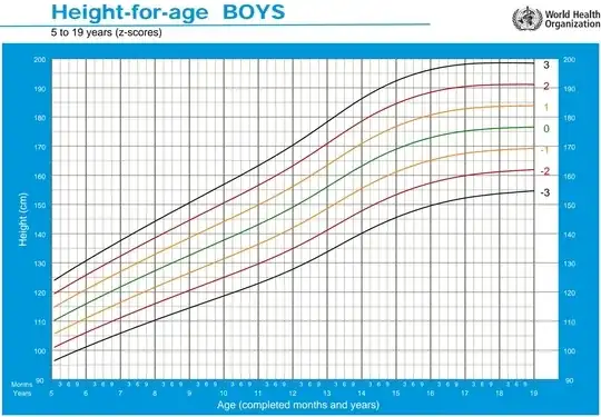

Now let's look at the whole dataset in a chart:
WHO Chart
See how at age 13 there is the start of a growth spurt, that continues almost to the age 15 when it starts to slow down. Between 15 and 17 it starts to level off, and from 17 to 19 there's almost no growth at all. From 5 to 11 a simple algorithm can easily solve the equation in either direction, beyond 11 the algorithm is not so simply but it still can be solved with a polynomial.
For a neural network once it gets on track and thinks it is coming up with a solution a monkey wrench gets thrown in to the works. Look at the "Alice and Bob example" (from 'no free lunch'), trying to solve the problem rationally requires knowledge and intelligence to avoid getting trapped.
Alternatively an Equation Solver can intelligently brute-force a solution, providing a relatively simple equation that can be used efficiently on large volumes of data.
Once you have a simple equation you could apply it to a huge dataset, like the Census, to check for errors such as age not matching height. A neural network would be better for discovering that age versus height was different than the average in a particular area and supply the reason (distance to inexpensive high quality food, versus earnings, and a sprinkle of education) whereas a simple polynomial wouldn't have the additional knowledge buried within it to make deductions.
A neural network doesn't comprehend (literally or figuratively) why a solution that was working later fails; it needs to continue, to learn to ignore it's success, to reach a working solution.
A non neural network solution doesn't care (literally or figuratively) whether it was on track, figured something out and learned to apply it, it only knows to minimize error and eliminate variables.
That doesn't mean that each couldn't switch roles and learn, or be programmed, to do the job of the other; but then the neural network would be pedantic about precision throughout (slow) and the solver would over analyze (calculate left or right with high precision) rather than simply weigh the outcomes with adequate precision for each step.
