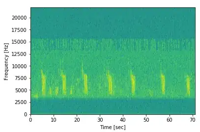

For example, have a look at the spectrogram of each bird (there are only 66 different genus types), to see how you might extract more data from the samples. Here is the spectrogram of a sample taken from here:
bird call spectrogram
We can see that there is clearly a repeating pattern! We can see those tall light green blocks intermittently appearing throughout. So although the sample is indeed just over 70 seconds of sound, the call of the bird seems to really only last about 2 seconds!
Either with a simple filtering algorithm or even building a model to find those chunks, you could extract those chunks and only work on those, perhaps along with the data regarding the gaps between those chunks.
That is just one example of data-specific pre-processing; I am sure there are many other ways to improve the information density.
