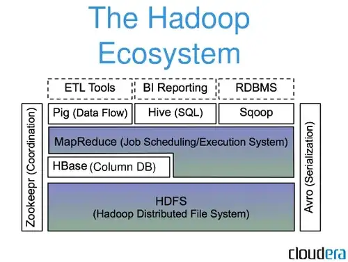

Hadoop is not a database, hadoop is an entire ecosystem.
Most people will refer to mapreduce jobs while talking about hadoop. A mapreduce job splits big datasets in some little chunks of data and spread them over a cluster of nodes to get proceed. In the end the result from each node will be put together again as one dataset.

now hadoop would be done with everything. You can now load the result into the HDFS (hadoop distributed file system) or into any DBMS or file.
Thats just one very basic and simple example of what hadoop can do. You can run much more complicated tasks in hadoop.
As you already mentioned in your question, hadoop and noSQL are complementary. I know a few setups where i.e. billions of datasets from sensors are stored in HBase and get then through hadoop to finally be stored in a DBMS.

Hadoop is a system that is meant to store and process huge chunks of data. It is a distributed file system dfs. The reason it does this is that central to its design it makes the assumption that hardware failures are common, thus making multiple copies of the same piece of information and spreading it across multiple machines and racks, so if one goes down, no problem, we have two more copies. Here is a great link for Hadoop from wikipedia as well, you will see that it is, in my opinion more than just storage, but also processing: Hadoop
