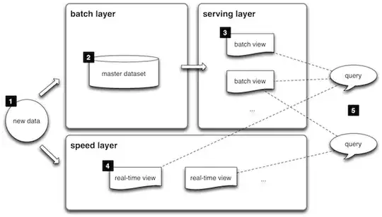

but the architecture diagram shows that the merge layer is able to query both the batch layer and the speed layer in one shot.
How to do that?
Your batch layer is probably a map reduce job or a HIVE query. The speed layer query is probably a scala program which is execution on the spark.
Now how will you merge these?
Is there any guidance.

From what I understand of the objectives of the lambda architecture your point:
Is not what was intended. The batch layer is not meant to be directly queried against, but rather feeds a serving layer, possibly a simple key-value store, for low latency queries.
lambda architecture diagram
Check out http://lambda-architecture.net/ for a more full explanation.
