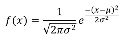

This is a generalised question. There are lots of ways to normalise a given distribution. For example:
  • Normal distribution: You can physically inspect your function by graphing it against variables and then convert it to Normal Distribution as given here. Or you can simply find out the mean, andvariance` and then use the formula enter image description here
  • Maybe you can use simple exponential distribution as given by other answers like 1 - n ^ (ax) / (Sum of all x's put in the equation in the distribution) or maybejust direcly apply softmax function.
  • You can use the inverse function like you used and then divide by the sum of all values.
The point I am trying to make is that there are 100's of ways to convert an array into probability distribution, you need to choose what works best for you. Also it is very important to note that if you are using this probability distribution to calculate loss and then optimise your model using gradient descent you must make sure the loss function is convex which directly means either your loss function or your PDF should take care that the ultimate loss is convex.
