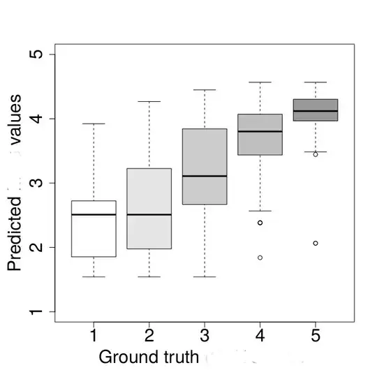

I am using machine learning models to predict an ordinal variable (values: 1,2,3,4, and 5) using 7 different features. I posed this as a regression problem, so the final outputs of a model are continuous variables. So an evaluation box plot looks like this: Ground truth vs. predicted values

  1. One way I could think of is to categorize predicted (continuous) values into bins, and compare predicted distribution to the ground truth distribution using the Chi-Square test. But that doesn't make much sense, i.e. we have a machine learning model that perfectly predicts ground truth values 2,3, and 4, and values 5 predicts as 1, and values 1 as 5 - Chi-Square test that I propose here would reject the null hypothesis, although the model is mispredicting 2 out of 5 values.
