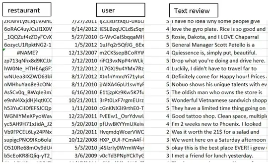

I have data where there is text for each user A visiting a business B. I want to find similarity between each user using their text.
Question 1: Which NLP method should I start with?
I have tried cosine similarity, I know its a great method but it's very slow in computing similarities.
I have thought about extracting important information from text (for example: Term Extraction, I don't want to use LDA) and computing similarities between that information.
Question 2: Any suggestions?
this is how text data looks like
