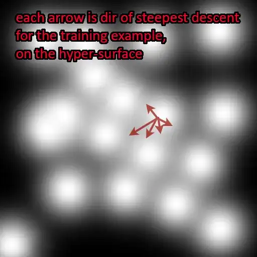

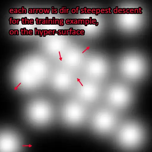

In Full-batch Gradient descent or Minibatch-GD we are getting gradient from several training examples. We then average them out to get a "high-quality" gradient, from several estimations and finally use it to correct the network, at once.
But why does averaging the gathered gradient work? Each training sample ends up in a distant, completely separate location on the error-surface
Each sample would thus have its direction of a steepest descent pointing in different directions compared to other training examples. Averaging those directions should not make sense? Yet it works so well. In fact, the more examples we average, the more precise the correction will be: full-batch vs mini-batch approach

That is not a correct visualisation of what is going on. The error surface plot is tied to the value of the network parameters, not to the values of the data inputs. During back-propagation of an individual item in a mini-batch or full batch, each example gives an estimate of the gradient in the same location in parameter space. The more examples you use, the better the estimate will be (more on that below).
A more accurate representation of what is going on would be this:
