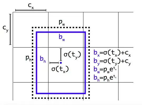

As far as I understood, YOLO3 assigns N anchor boxes to each grid cell (image is divided into SxS grid cells) and thus, the prediction of a bounding box is relative to a given anchor box from a grid cell (that one anchor box that has the highest IOU with the ground truth). The formulas are below:
YOLO3 BB
Therefore, how should I prepare ground truths so that YOLO3 can understand them? Do I have to, somehow, reverse those formulas? Also how to account for different number of scales and different number of anchor boxes?

Therefore, how should the ground truth for the person's bounding box should be encoded? Should it be an offset from a particular anchor of a grid cell? This is what it's still unclear for me.
